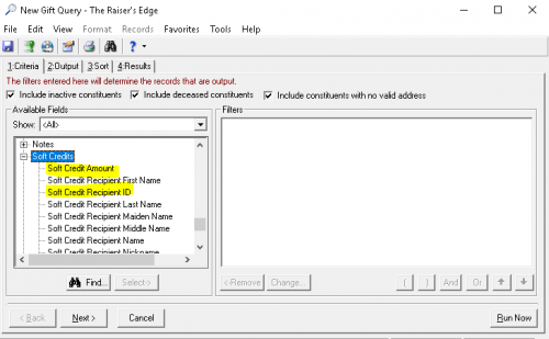

I'm working on accrediation reports and I need to find out how much was soft-credited and how many donors were soft-credited. I've been tinkering with queries and reports (and will experiment with exports as well) but I can't figure out how to get just soft-credit information. Has anyone else figured out a way to get that info (relatively) easily?
@Wendy Bermudez, you can get this information in Queries. Pull a Gift Query with criteria “Soft Credit Amount > $1” and Gift Date = Last Fiscal Year. For Outputs, put “Constituent ID”, “Soft Credit Recipient ID”, “Soft Credit Amount”, and Gift Date.

- If you pull a Gift Query, it will still show the $101 gift amount but you can more accurately output the soft credit information showing recipients and soft-credited amount ($40 vs $101) straight from the Query itself. The query results will even split the soft credit recipients each onto their own row, as below.

@Faith Murray This method was definetly super helpful and was exactly what I needed! Thank you so much!!
