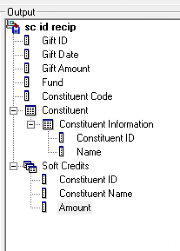

When we receive DAF gifts, we hard credit the DAF (Benevity, Your Cause) and soft credit the constituent who triggered the gift. At the end of each fiscal year, we take a snapshot of our gift data and would like to see the constituent ID of the hard-credit recipient along side the constituent ID of the soft-credit recipient.
Using a gift export, when I select Constituent ID and Name, the constituent ID and name of the soft-credit recipient populates. My test query contains five gift IDs; the export produces 564 rows. The export is exporting all gifts from each soft-credit constituent IDs associated with the original five gifts selected for the query.
