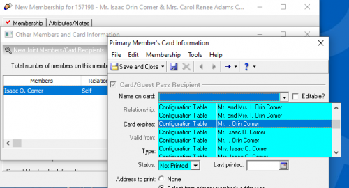

@JoAnn Strommen
1.Open an existing Membership record2.Click “Members & Cards”
3.Double click any one of the rows in the “Other Members and Card Information” popup
4.If “Editable” is checked, uncheck it.
Now “Name on card” becomes blank and has a drop down arrow next to it. The list presented is a combined list of Addr/Sal – first ones from the Individual’s record, then from Configuration Table

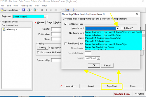

@JoAnn Strommen
Please ignore the previous response. Despite you saying you don’t have the Membership module, for some reason, I answered as if that was your question.On an Event Participant the Addr/Sal stuff is here:
Open a Participant, then click Tags/Cards. The “Name to print” dropdown pulls from Addr/Sal – both the ones on the Participant’s constituent record (if they have one) and also from the Configuration Table.
Thank you for your replies. I'm more looking for the hidden places Add/Sals can hide. (Nametags, etc.) Thankfully we don't have the membership module, so that removes that mess from the equation. I think I have narrowed things down to the bad add/sals being on ancient event nametags, and being marked editable.

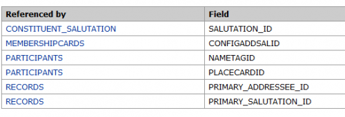

@Amy Barker
The RE7Schema.chm file is a little bit outdated these days, but it is probably still accurate enough to help here.
According to it the SALUTATIONS table is referenced by all of the RE tables in the left-hand column:So that means in addition event participants possibly having name tags, there's also place cards.
I can't 100% guarantee it, but that would seem to be it. Because AFAIK the only major update to RE that's not represented in the schema documentation is the GDPR Consent stuff.
Constituent_Salutation corresponds to the Additional Addr/Sal section of the Constituent Addr/Sal tab.
MembershipCards obviously goes to the Membership table.
Both the Participant ones appear in the same popup.
And the other two in RECORDS are for the Primary Addressee and Primary Sal on the Constituent Add/Sal tab.
According to the documentation, that's all of the places an Addr/Sal can live.
3 -
@Isaac Comer
Exactly what I was looking for! Schema! Covid brain would not let me find that word. Thank you!0
