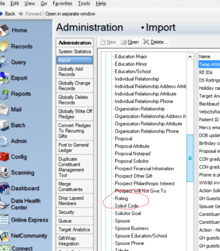

Have you imported data into RE? There is a section in import under Constituent where you can do this.
You'll need the RE ID and some of the circled fields for your import:
I would suggest you test your import with one or two records to make sure you have it set up correctly. Then do the rest with the same fields.
