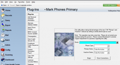

You can use the “Mark Phones Primary” plug-in to globally mark phones primary. I use this routinely.
