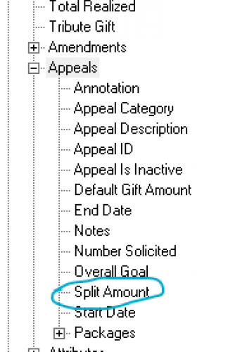

You'll want to expand the Appeals node and use the package and split amount fields within there, instead of the main gift amount field which has the total amount of the gift regardless of whether the whole gift meets the criteria or just part of it.
You might also want to just use the query to specify the package you're interested in, and then get the actual amounts out of an export, so that you don't end up with duplicates.

Hi @Julie Swedberg - You want to use Split Gift Amount. If your query is pulling by Appeal, use the Split Gift under Appeal. See How to query on the split gift amount (blackbaud.com). Hopefully this and @Alan French post help you out.

As Barbara posted you will want to use Split Gift. It takes a little getting used to pulling that field but it should be what you need.2 -
@Julie Swedberg The split amount shows up in a few places but not in every query. But gift queries and event queries have that filed as well as the appeal split amount that JoAnn mentioned.
