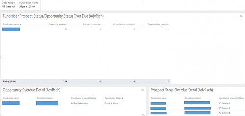

Hi Sara, We built an insight & dashboard.
Any field that is queryable, allows for menu options, and includes a date field could work. I myself would probably veer away from Actions at our org simply because that tab gets so crowded and because you could accidentally enter multiple “Status” actions, confusing your reporting. I tend to prefer an Attribute/custom field with a drop down menu, date of status, and then allow only one per record.
Using Actions have the benefit that you can run an “overdue action” list specific to that action type. But Attributes are beneficial because you can restrict to only one per constituent and it's easy to find/view. You can even pull a list in NXT by Custom Field Date to pull “old” status attributes that have sat too long.
One could conceivably even use the Membership function (as it includes end dates that can repurpose to due dates), but that wouldn't be my recommendation.
This is what it looks like for anyone interested.
