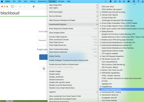

When the "In-process cookie cache" experimental feature is turned on it creates an infinite loop when users sign out. We are working to resolve this issue. To alleviate in the interim, please have your users turn off the feature within the menu selection seen below. Or if a school IT admin has control of Safari app settings that can be pushed out to users, that may be an option too.
