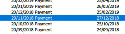

Hi all. Long time user of Raiser's Edge over the years in different capacities. In a new organisation and looking for advice about how best to ‘tidy’ some transactions. Over the years some recurring gift transactions that should have been skipped haven't been, instead the next payments sitting against the date that should have been skipped. This means that now there are recurring gifts with very skewed dates for next transactions coming in. If we ever wanted to accurately do recurring gift batches, this would surely be a problem (most gift entry here is manually added at present).
Before I mess with financial data (some very old!), I wanted advice on how to ‘re-align’ these? Essentially, in the example below, I'd want to skip/miss out November entirely as the gift was skipped/didn't appear. And because December's gift is now attached to Nov, it's thrown off everything since. You can see similar continues to happen down the line with this gift.
I worry by messing with this I'll skew the data further. Just treading carefully. Any hand-holding steps here much appreciated!
Maybe someone else has more mastery of recurring gifts but in my experience they are too difficult to change to make the effort worth it, ESPECIALLY if they're posted to Financial Edge. Lots of things get quite wonky with them once you start going in and messing around. When I did this kind of cleanup, I'd just mark the old recurring gift completed and make a new one that's ‘back on track’.
5 -
Hi @Henry Gray - Welcome to BB Community! I second what @Kylea Johnson has said. Updating anything having to with a recurring gift schedule is difficult, especially when payments are already applied. Unless there is a specific need to make these match, I recommend you keep it as is and make it a policy that if a transaction is ‘skipped’ it needs to be updated on new recurring gifts, moving forward.
Thanks - good to know. This is the exact reason I was definitely going to ask here before doing anything. I think that makes most sense.
Thanks! I think this just makes it clear that going forward there should be simple steps taken to ensure things stay in line in my organisation. Most of the issues are from many years ago to be fair.
