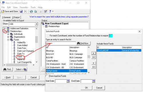

Jill, if you are needing to pull a mailing list, you will want to do so through Export, rather than Reports. Reports are not really made for mailing lists. You will create a constituent Query to group anyone with a relationship to a scholarship fund. Then you would attach that Query to an Export.
The Export will allow you to output the Processing address, as well as the named Fund relationships. For the latter, go to the output tab and select Relationships - Funds - Fund, and then select only those funds which are your desired scholarships. At our org, it would look like the pic below.
Thanks, I will play around and see if I can make that work
