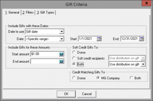

Here's the gift summary part of an export set to show all gifts $1 or higher that have a gift date of 1.1.2021 through 12.31..21You can adjust your filters and gift types in need be. But this is the field that would show the total amount of 2021 gifts donated for all of the constituents in your query. I'd set up your query to pull anyone who donated in 2021 but you'll know best which constituents you want to include.
