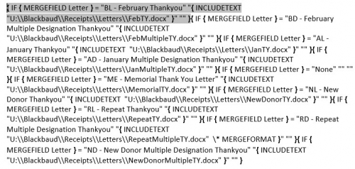

This is the working conditional master merge file we have. We have two main letters that change each month, along with several others that are needed on a regular basis. I do not know yet how NOT to print a page that does not receive a letter (as we have those too-the printer ejects a blank page for those.) The master copy (one of them!) is saved on a drive that multiple people have access to. That way when a letter is written, it can be saved. When another needs to tweak the spacing, they have access, along with the person who generates the letters. Hope this helps!
You can see in the path, parts that have the RE format, then you have the path on the shared drive of where the letters are saved. 2 -

@JoAnn Strommen I don't think the data fields matter in the letter anymore, as we will be merging them externally. I think the only time you need to set the fields is in the letter export, which should have all of the fields you need. So basically, you are just adding the name in RE so that your export has the name (ie. “New Letter” in the Letter field), and the actual data in the template. Hopefully, you are just pulling fields that already exist in your regular letter data file.
EDIT: So here's the way the process should work, in essence. Granted, I haven't had the time to test this, but in theory.
- Create new letter type in RE
- Add new letter type to letter export or create a new letter export
- Create letter template externally of RE with the appropriate merge fields.
- Add new letter type to your master merge document.
- Wash, rinse, and repeat until you get it working and formatted correctly.
5 -
@Dariel Dixon is correct - that is exactly how it works. I have probably done this at least 100 times during February, helping clients through the process.
I worry about the long-term maintenance of this just because of the Microsoft Word quirkiness. I encourage people to save the knowledgebase solution and video links, and add their own findings to their internal documentation. It should be very easy to add a letter, specific documentation about how to avoid the random formatting changes should not be ignored.
Most client instances work best when you uncheck the “preserve formatting during updates” box, but I've had a couple work best when it IS checked. Most are working just fine with XLSX formats as well as CSV. Some have spaces in letter names and some don't. Again - includes links to the Blackbaud-created documentation but be very specific in your internal notes about what was DIFFERENT from that documentation and WHY. If you know! :-)
