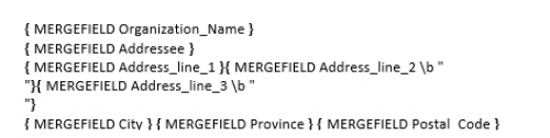

Here is a screen shot from our thank you letter. We have some address that have up to three address lines, so we suppress address 2 & 3 if blank.

Thank you so much, Kylee. It worked
