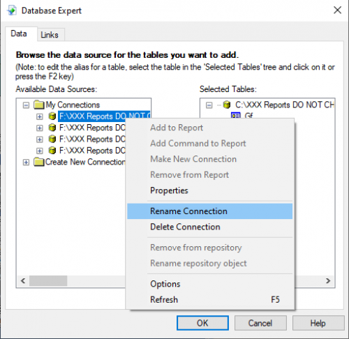

I don't think any of these steps need to be taken. I think you can reset the link in Crystal Reports by using the database expert wizard. It does take a higher level of understanding, though. But you will have to rename the links for a while.
Legend! Just created a report on my local machine, once finished renamed the data connection using Database Expert to match the hosted files location. Copy and pasted the report into the hosted files. Updated the RE Export file location to export directly into the hosted files ensuring it matched the renamed data connection. Ran the report in Raiser's Edge Custom Reports and worked first time.
