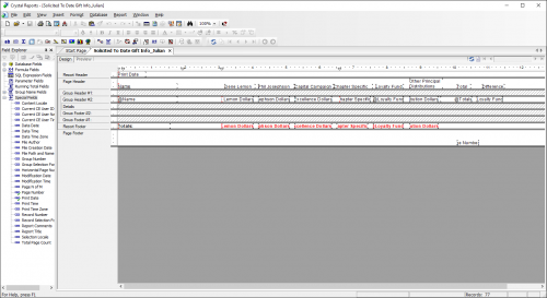

This is what my current report looks like
Thanks, can you send a screen shot of the design tab? Might need to do some grouping and summary fields.
You have a couple of options here. The first is to export each of the gifts separately so you'll have them in separate tables, so you'll have CnGf–1 and CnGf−2 etc. then you'll be able to put them on one row.
Your other option is to go ahead and export all the gifts in one table like you're currently doing, and do a subreport for each fund. Each subreport filters for only the gift you're looking for, and you put each subreport on the same line.
