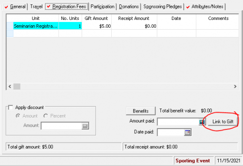

Sabrina, are you making sure to link your gift to the registration? You can do so either through the participant record under the Registration tab, or else during gift batches through Gift - Apply, IF the registration is already entered on their donor record.
Thanks, Faith! I looked into this, and I believe I misrepresented the issue. For these registrations showing as $0 Revenue, there is no gift to link to. The batch action from OLX to RE, is creating a receipted registration fee and contribution amount, but it is not creating a gift applied as registration fee. For example, looking a participant, clicking Link To Gift - there is no matching gift to link to. I may be approaching this wrong… my end goal is to have a query that pulls Event Number Registered and Total Registration Fee Revenue to provide a snapshot of event performance for tracking.
*UPDATE: Solved! The issue was the batches were not committed. Sharing here for any newbies inheriting mid-event - double checking that batches are committed. This way the gift is created and revenue displays for the event.
