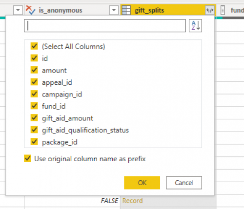

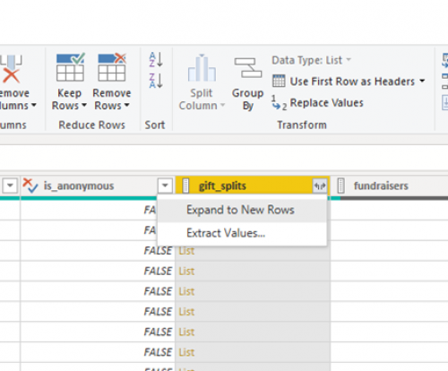

@Andrew Wilks You can get the appeal id and package id from the Gift API (you will have to expand the gift splits column, see screen shots below). Then you would need the Fundraising API to connect the Appeal ID from the gift information with the Appeal ID from the Fundraising API so you could get the Appeal description. It does not appear that you can get the Package description, just the Package ID.

Just select the information you want to see to show them in separate columns. 0 -
@Dan Snyder Thank you for the tips. I'm afraid we're struggling to see how you got to the columns that included gift_splits. Would you mind just screenshotting us through the process? It's frustrating being so close, but not being able to find it. Your help is much appreciated!
No worries. We have figured this out now!
