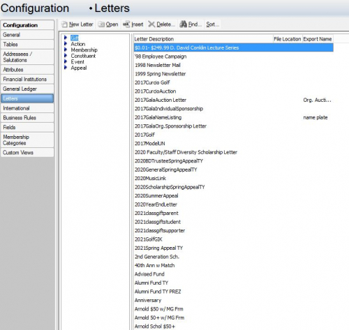

When I go to config → letters → gifts I have a list of letters I should be able to pick to acknowledge my gifts with. The question I have is where are these letters stored so I can make changes to them? If I choose a letter to use in mail merge it will not recognize the letter and I can't acknowledge the gift. Thanks in advance ?

From your screenshot it looks like most of your letter codes don't have an export associated with them - that's where the actual text of the letter would be if you are producing a letter from a gift record for just that gift. If you double click on the letter description, it should give you the option to either link the letter code to an existing export (if you've already got one set up for that letter somewhere) or create a brand new export. You'll need to select the fields that you want to merge into your letter, and there's a button at the top to “edit merge document” where you can write the letter itself.

Miki, it looks like many of your letters are (or should be) also Inactive? We, also, have a “monstrous” list of Letters, but only about 12 of them are Active. Anymore, I like to keep the letter names generic so you can use them year after year: so instead of “2020 Spring Appeal”, we just name it “Spring Appeal” and update the content every year. That way we don't have a growing list – because once a letter type lives on a gift record, you can never delete it unless you also delete the letter code from the gift record.
