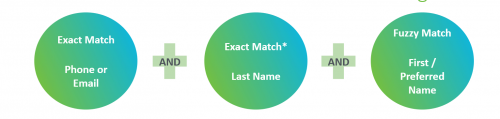

Hi Samantha - I'm using NXT Events Registration form and pre-loaded invitees. I registered and despite the last name and email being an exact match, they are duplicate records. Is there anything they needs to be set-up in advance to ensure that people who register on the form are matched with the pre-loaded invitees?
Hi Michele,
There's a bit more detail that I didn't add in my original post on matching. We match on:
If you are finding that email address and last name are matches, then usually we find that the first name was incorrect (ex: record has "David" and registrant entered "Dave." Another common example that will throw a duplicate is if multiple matches are found. At this time we are not making an assumption that in a multiple match situation, that a matching name already on the event would be "the match." Typically this happens when you've got data that needs to be cleaned up.
In the event that we did create a duplicate, the best way to manage this is through Tools --> Data health. By merging the duplicate that was created with the intended record here, you will be able to merge the registration into the record you already have added as a participant on your event.
We have some enhancements to both the matching algorithm and the duplicate handling process coming later this year as we continue to refine this process based on customer feedback. Feel free to reach out to me at samantha.mcguin@blackbaud.com if you want to discuss further!
