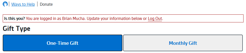

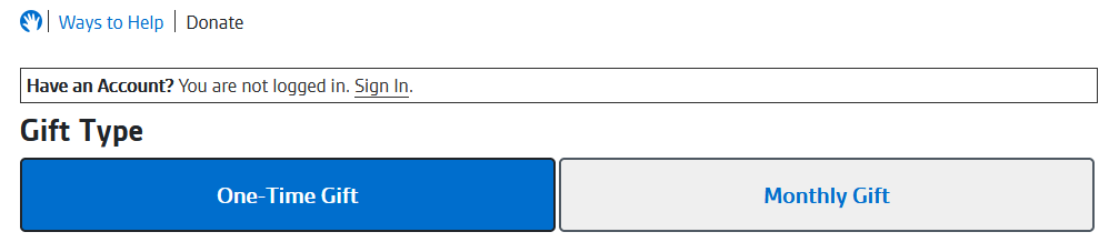

I added a little block to the top of our donation forms that alerts the visitor if they are logged in when donating.
My forms are all API forms, but you can also do this with S-Tags in a caption field on your form builder form.
I think that would look roughly like:
[[? **::*[[S1:cons_id]]*:: "Have an Account?"::"Is this you?"]]
