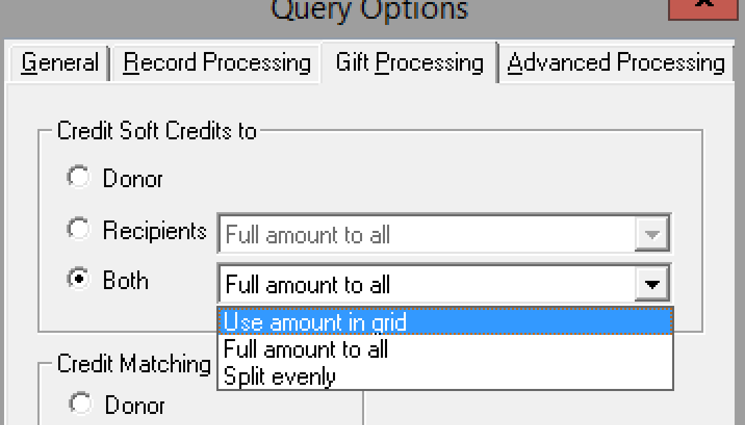

I have soft credited multiple people for portions of gifts at times. When you do queries, exports, and reports down the road, make sure you select "Both" and "use amount in grid" so that the soft-credit recipients are queried / reported for only their portion of that big gift.
In terms of anonymity, you won't be able to accomplish what you want by using the checkboxes. Either the constituent needs to be anonymous (Bio1 / Org1 tab) or the gift. But as you've pointed out, the gift itself isn't anonymous - only that donor's portion of it.

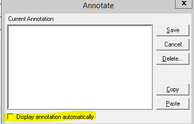

Thanks for the great suggestion! Yesterday afternoon I did just that...noted it on the donor record about the SC gifts from specific sources. This actually generated another question in my mind: Is there a way to put a "pop-up" alert/notification on a record to bring attention to those that may have special circumstances? I was able to do it in Blackbaud CRM.
You can set up Business rules under Configuration options.
You need a query of relevant records and then create your rule. Pretty straightforward.

Thanks for the great suggestion! Yesterday afternoon I did just that...noted it on the donor record about the SC gifts from specific sources. This actually generated another question in my mind: Is there a way to put a "pop-up" alert/notification on a record to bring attention to those that may have special circumstances? I was able to do it in Blackbaud CRM.JoAnn Strommen's answer should meet your needs in database view, but those pop-ups would only show up in database view. For web view, you would need to use the annotation and select the option to display the annotation automatically so it will show up at the top of an NXT record as well.
You could also try using the Annotate icon (Paper with the pin) icon on the donor's record. There is a check box in the popup to display the note automatically (when the record is opened).1
Thank you all for this invaluable information. The annotate option is what I was looking for.1
