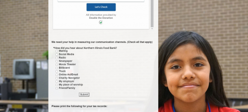

Hi,
Is there any way to customize the confirmation page after the donor completes their donation? I know we can add our own text with the transaction details in the form setup, but it is very limited.
My boss sent over an example from another Food Bank and she really likes this option with asking them how they heard about the organization:
Not sure if we can customize our confirmation screen further than what is available in Online Express

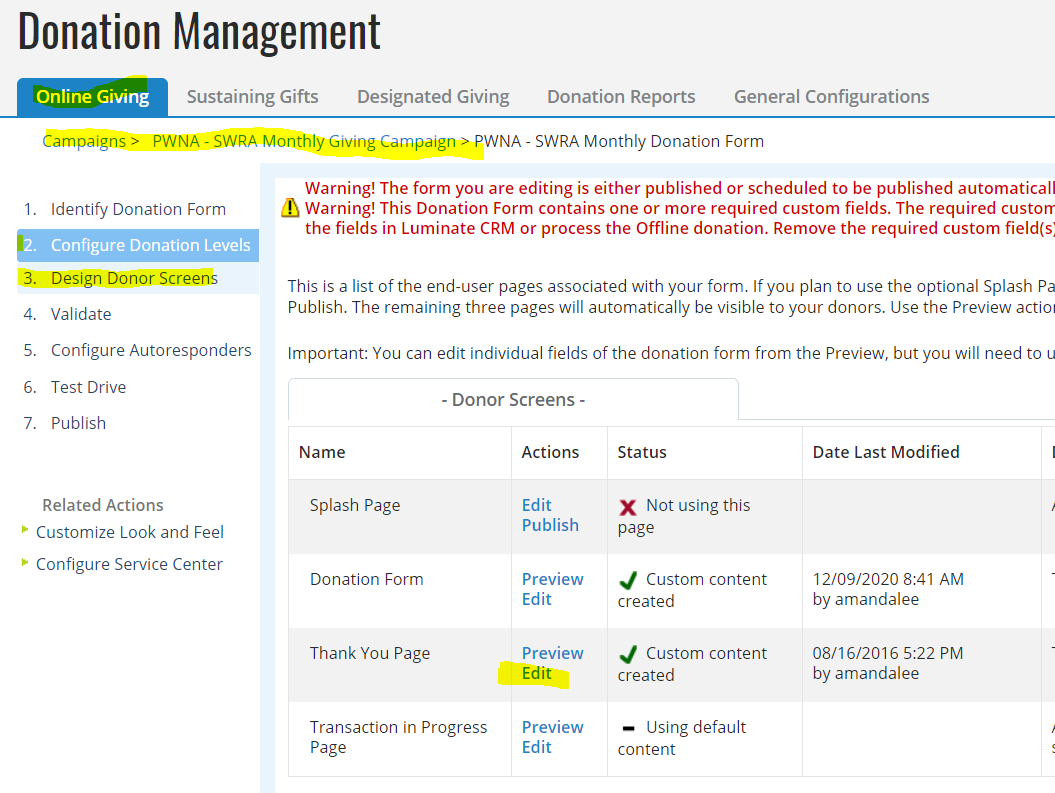

I don't know about adding the "check all that apply" option, but I know you can edit the thank you page.
You could always add a link that says, "Thank you for your gift, please take this short survey to answer........"2 -
Thank you for sharing, although we do not have Luminate0
Lauren Fardella‍ - Based on my knowledge of OLX, what you want to do is unfortunately not possible. If you haven't already, check out the OLX Idea Bank and RE-NXT Idea Bank and make sure your idea is represented.
Alternatively, you could add the question to the main body of the form or place an embedded survey somewhere else on the webpage. It definitely will not look as clean as the shared example from the Food Bank.3 -
