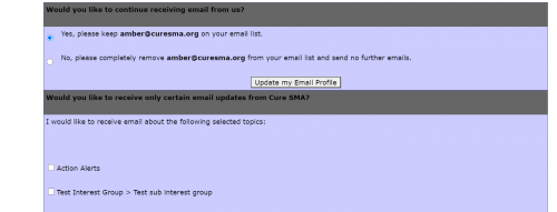

On the subscription management page, is there a way to hide sub/child interest groups? We want to use these internally and then use the top level/parent opt out group to suppress anyone that no longer wants to receive related messages.
However, with how we were thinking about using this, there would be an overwhelming number of sub interests publicly listed on this page.

One option would be to set all of the "internal" child Interest Categories so that they are in the "Administrators Only" security category.1
Thank you! That solved my issue.0
