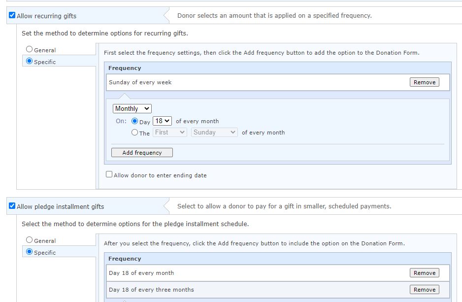

You can use the specific frequency function, we chose the 18th to help alleviate any heavy gift processing traffic that may occur on the 15th. So far our Donors are ok with this choice.3
We ran into the same problem! We ended up creating a "recurring gift" page and/or buttons to direct donors to that specific page. On that separate page, we use the original Donation Form where you can specify dates like Elaine posted. We only use Donation 2.0 for one-time gifts ... hoping the settings will be updated soon on Donation 2.0 to specify dates for recurring!1
