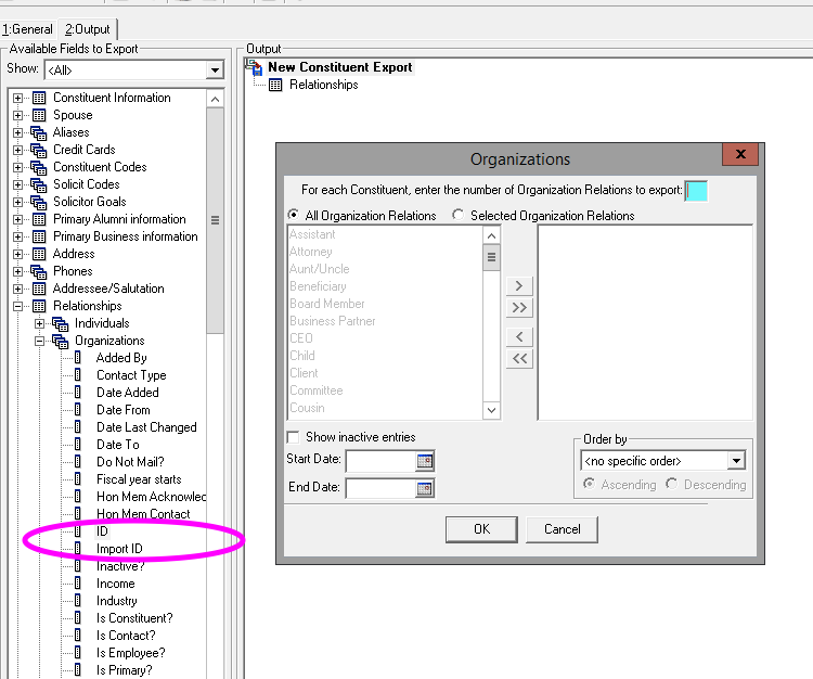

You need to use export to get this information out of the system. Under relationships, select organization. When you click on ID, you then select which values and how many of the values you want to export. From there, add import ID to the export and you should get what you're after ... if the relationships have been reciprocated.0
