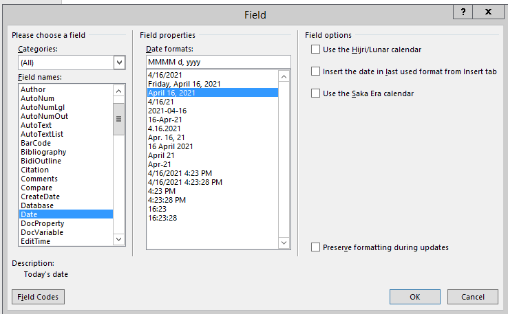

Hi Alex,
Microsoft Word has "switches" for merge fields. When you are in your letter set-up, you can highlight your merge field for the date, right click and choose Edit Field. In the Field names box, find "Date" and it will give you options under the Field properties for Date formats. Here's the window that opens when you click on Edit Field:0 -
