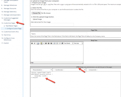

There are many ways to tackle this, but the quickest would likely be to just add some CSS to hide that button on the Company Pages.
To do this, you would navigate through this path:
TeamRaiser > Edit link > 13. Customize Pages > Default Company Page (customize link) > HTML Area
<style type="text/css">
a#sidebar_donate_button {
display: none;}
</style>
See this screenshot:
