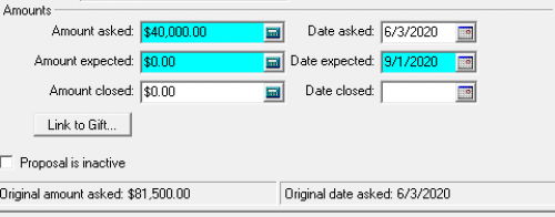

Just to chime in on the Original Ask Amount piece, there is a field in database view at the bottom of a proposal record where the original ask amount and date are listed and you can export those fields. Unfortunately, it is not in NXT. However, I would agree with what others have said about using the ask amount and expected amount fields as it would lead to good information in the canned NXT opportunities reports.
