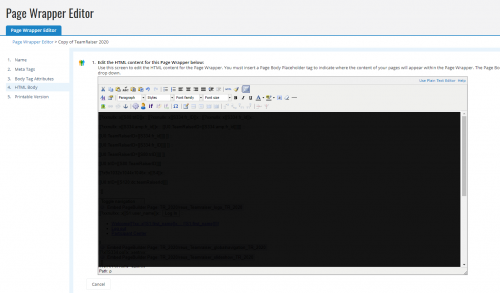

I'm working with Daniel on this, and your advice helped but we're hitting some more roadblocks... I finally have access to the Page Wrapper Editor, and it's all starting to make sense. But our issue is we want to modify the slideshow component in our TeamRaiser.
Inside the Page Wrapper Editor, I see that I can select different components to include in the Page Wrapper. By default, our wrapper has the slideshow component called "reus_Teamraiser_slideshow_TR_2020". So that we wouldn't modify the slideshow for every TeamRaiser, we copied it into a new one called "Trek4Missions_reus_Teamraiser_slideshow_TR_2020" and we made the changes we need to that one.
Now inside the Page Wrapper Editor, I'm trying to update it so it points to Trek4Missions_reus_Teamraiser_slideshow_TR_2020 rather than reus_Teamraiser_slideshow_TR_2020. When I go into the HTML view and simply update the name of the component, nothing happens - I don't have an option to save it, and when I leave the page and come back to the HTML Body section of the Page Wrapper Editor, it reverts back to reus_Teamraiser_slideshow_TR_2020. From the WYSIWYG view, I click the Components button, and from there I can navigate to Content > Reusable Page and there I see all the reusable pages - but not the custom one we created. How can I add a custom page component to our page wrapper?
Sorry if that was a confusing description, but hopefully it made sense - and let me know if you need me to clarify anything. Thanks again for your help!0 -

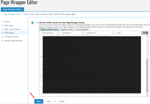

Hi, Nicholas. It sounds like you're on the right path, but odd that you're not able to save the changes to the Page Wrapper. At the bottom of the editor, there should be a "Next" and "Save" button (maybe it's just hidden off the bottom of your screen view?). See my screenshot below. Once you save this version, you will then need to make sure you publish it (so the new version is the "live" wrapper). There's a little nuance that can sometimes cause an issue, where a draft wrapper that is "Previewed" will stick in the browser, even if not live. So if you're not seeing the live changes, maybe just try to "Preview" the new version to see if you can force your browser to use it (or test the live site in another browser). Hope that helps. - Jon

Hi, Nicholas. Ahhh.. I believe the problem is that you're trying to edit the Active Version. That isn't allowed. So, instead of clicking on "View Active Version," you'll want to click on "Manage Versions"... and then copy the active version (or unpublish it if you'd like you edit it). Hope that does the trick! - Jon
