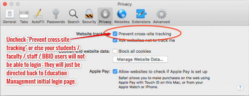

When a user experiences the issue, they will keep on landing on the school login page after entering their password.
Here are the various scenarios you’ll want to be aware of as you triage this potential issue:
Users of the latest versions of iOS and Safari will need to turn ‘off’ the setting called ‘Cross-site Tracking’ that is turned ‘on’ by default. Unfortunately, this setting interrupts the sign-in flow between myschoolapp.com and Blackbaud.com and blocks the cookie necessary for the redirects to authenticate successfully. If users turn off that browser setting, they are able to login. This impacts iPads and iPhones as well as mac laptops/desktops.
Firefox and Chrome have a similar setting that is not turned on by default, but may have been set by the user.
Review the KB article for the steps to change browser settings in a variety of browsers.
Once you have changed the browser setting, you should also clear browser cookies and restart the browser to get a fresh connection.

We find the majority of users have no trouble making the transition to BBID and we appreciate all your detailed instructions. This "Cross-site tracking" setting has been of particular use.
If I understand correctly the steps should be:- In Settings > Safari, check to ensure cross-site tracking is disabled
- In Safari > History, clear all history which should remove outdated cookies.
- Restart Safari browser.
- Attempt to sign-in again.
