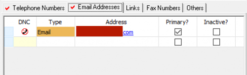

@Alan French I've also got this problem. I've exported every email column I could find, all under phone numbers and no result, despite the fact that the constituent does have an email. I checked another constituent who is marked “DNC” and “Primary” like this person and their email is showing up, presumably because it's stored somewhere else. Where's the email being stored that I can't find?
@Jason Van Over Emails can be on relationships, individual and org, participant records. I suppose memberships if you have that module too.

Thanks so much for your response! If it were in one of those other places would it be showing up on the constituent record here?0 -
@Jason Van Over No, you have to deep dive in Relationships > Individuals > Phones… Do this for each type of relationship like Organization, Contacts. Even Banks if you might have it there.
Then another deep dive into Event Participants….
@JoAnn Strommen
But it is showing up on the constituent record under “email addresses” but is not showing up in my query. I think it may have miraculously started working after trying exports. I went back to the query and now “email 1” is showing everyone's email address. Not sure what I did but it's very, very, very unclear. Thanks for your help!0
