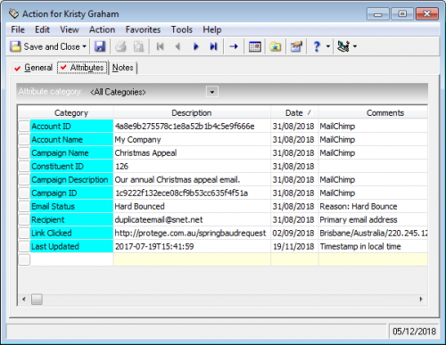

We use Mailchimp and add the emails as actions, with any activity (opens, clicks, unsubscribes etc.) recorded as action attributes.3

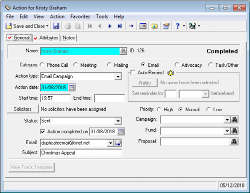

Not intended to be a plug, but this is how our Springbaud email campaign management plug-in works:
Cheers,
