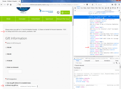

Hi all! Update in case this is helpful to anyone else doing designated DIY TR fundraising - here is what I've come up with so far. Seems to work fine, but again, I am still a monkey-see-monkey-do js/jquery tinkerer, not formally trained yet. Would LOVE the feedback if any jquery-savvy people see issues with this!!
//default designation selection radio
$('input:radio[id=single_designee_designated]').val(['designated']);
//load in designation value; custom_number5 = Team Children's TR / custom_number6 = TCC Birthdays TR; suspense designation 1041 if custom field is empty
var TCCdesignee='[[E48:[[S334:FR_ID]]-[[S334:PROXY_ID]]:cons.custom_number6]]';
if (!TCCdesignee) {
$('#single_designee').val('1041');
}else{
$('#single_designee').val(TCCdesignee);
Screenshot shows a temporary line of text up top confirming the contents of custom_number6 for the test fundraiser, and shows that the corresponding designation has been correctly populated (though of course I will hide the designation area once this is complete).
So this is working well in feeding the designee ID from the fundraiser (as identified from PROXY_ID in the url) as it is stored in a custom number field on the fundraiser's constituent record.
Sooooo step 2: I intend to have that custom number field populate from a couple of questions on the fundraiser's TR registration form - one which is a required single-selection drop down with the friendly names of the designees we want to offer, which I will then have a bit of code translate into the corresponding designee ID # and insert into a hidden question linked to the appropriate constituent custom number field for that TR's designee. If the desired designation isn't offered, the fundraiser can choose "other" (and fill in a note about the designation) - this will trigger our suspense designation and prompt our staff to manually review / update the custom field with the ID of the requested designation. Still a little work, but nowhere near as bad as it has been having to edit every single donation from our DIY TRs! Will post an update when I have that part of things set up, as well.
Just sharing my progress so no one spends time trying to answer the initial question! But again, would love feedback at this stage!! Thanks all!!!
