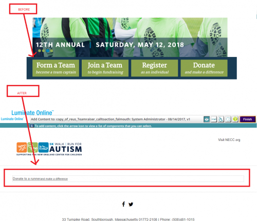

If you take a look at our CTA buttons on our live site (http://necc.convio.net/site/TR?fr_id=1040&pg=entry) you'll see we have four buttons; Form a Team, Join a Team, Register, and Donate.

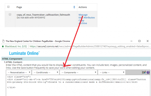

In our new wrapper we only have need for one of those buttons. I've deleted three of the buttons, but I can't get the one remaining link to look like an existing CTA button. It just looks like a link. See screenshot at the bottom of this post.
To start this process, I copied all of our wrapper components under Page Builder to a new Page Builder folder (not sure on the terminology?). I then edited the CTA component of the wrapper to include only one button.
Here's that code.
<div class="row">
<div class="col-sm-4"><a href="TR?sid=1031&pg=informational&fr_id=[[S80:trID]] class="button btn-primary btn-block btn-lg">Donate to a runner<small>and make a difference</small></a></div>
</div>

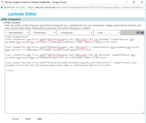

Here's a copy of all of the code in the CTA portion of the wrapper from the original/working wrapper.
Copy-paste of code from original/working wrapper with four buttons
<div class="row">
<div class="col-sm-3"><a href="TRR?pg=tfind&fr_id=[[S80:trID]]&fr_tm_opt=new" class="button btn-primary btn-block btn-lg">Form a Team<small>become a team captain</small></a></div>
<div class="col-sm-3"><a href="TRR?pg=tfind&fr_id=[[S80:trID]]" class="button btn-primary btn-block btn-lg">Join a Team<small>to begin fundraising</small></a></div>
<div class="col-sm-3"><a href="TRR?pg=tfind&fr_id=[[S80:trID]]&fr_tm_opt=none" class="button btn-primary btn-block btn-lg">Register<small>as an individual</small></a></div>
<div class="col-sm-3"><a href="TR?sid=1031&pg=informational&fr_id=[[S80:trID]]" class="button btn-primary btn-block btn-lg">Donate<small>and make a difference</small></a></div>
</div>
