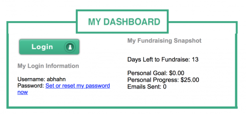

I'm currently challenged by the inability to include how much the participant has raised as well as their fundraising goal, within a TR coaching email.
I've reached out to Support, and they don't seem to deal with such a request as often – as it took a while for the agent to reach out to senior folks to confirm what was and was not possible.
Below is a great example of what I'm trying to accomplish. I believe this example is from another LO client, and I recieved this email in Feb 2018. So, fairly recently.
Any clues on how to do something like this?

I just did this for our coaching email. It took me a while but here is what I used. Hope this helps.
Days to Event - <convio:session name="48" param="your teamraiser ID:days-to-event"></convio:session>
Total Emails Sent:<convio:session name="48" param="your teamraiser ID:emails-sent"></convio:session>
Total Raised:<convio:session name="48" param="your teamraiser ID:dollars"></convio:session>
Fundraising Goal:<convio:session name="48" param="your teamraiser ID:goal"></convio:session>
