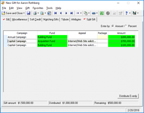

If you had split your gift across Campaigns ONLY or Funds ONLY, the suggestions above would work fine, but the moment you split gifts across both Campaigns and Funds you're going to have issues reporting this out in a single Crystal Report without creating custom tables with independant formulas for each area of the table. Consider the split gift below:
Campaign Split Amount is going to give us $800,000 and $200,000, but Fund Split Amount is going to give us $300,000 and $700,000. If you try to report on both at the same time you will see duplicates. I'm a Crystal Novice so someone with more experience may have a better response, but this is more of a problem with Export IMO than it is with Crystal.3 -
This is true.
Most gift information is stored in the table GIFT. Campaign, fund, appeal and package information are stored in the table GiftSplit (even if a gift isn't split, this is where it's stored). For some reason, that table isn't available as-is in Export -- instead they have those various amounts under campaign, fund, and appeal, all of which export separately and lead to this kind of duplicate gift counting.
Campaign Split Amount is going to give us $800,000 and $200,000, but Fund Split Amount is going to give us $300,000 and $700,000. If you try to report on both at the same time you will see duplicates. I'm a Crystal Novice so someone with more experience may have a better response, but this is more of a problem with Export IMO than it is with Crystal.BINGO! And it drives me crazy!!! Why on earth RE can't export these gifts the way they are stored in the database is beyond me. Fixing this is another one of the many CRITICAL "Ideas" that have gone ignored.
