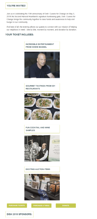

received html/css code for a custom email from a vendor, and luminate changes the code in the text editor so it displays incorrectly?
Hello - I received html/css for a custom html email that I'm sending through luminate emails. When I paste it into the plain text editor, and test send, it does not display correctly in gmail or ios, but does in outlook. There should be two colums and two rows of images, but in gmail and ios it is just one. It looks like luminate is actually automatically adding in some lines of code that I can not get out of there.
