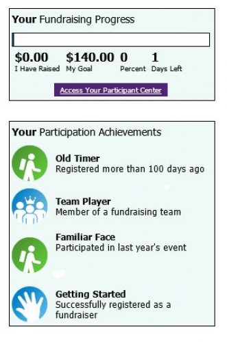

Thanks! I wrote that a couple of years ago. If people won't check their participant center, then I'll bring it to them. (Sorry to jack your thread J.D.)
Here's the code...
Its a reusable page used in all of our Teamraisers and sometimes in regular broadcast email, so the first thing I do is stick the Teamraiser Id into a session variable at the top of each event's stationary html.
[U0:myid=1720]]
The reusable can then read the proper TR Id from that variable for use in other S-Tags with [[S80:myid]].
Then within the stationary I include the resuable if the email recipient has a participant center. (Donors and some participant types don't fundraise, so they just get a picture.)
<table class="column" width="48%" border="0" cellspacing="0" cellpadding="0"><tr><td align="center" style="padding-top: 20px; padding-bottom: 20px;">
[[?x[[S48:1720:if-has-participant-center]]x::xTRUEx::[[S51:reus_teamraiser_email_participant_sidebar]]::
<img src="some_image_for_everone_else.jpg" />
]]</td></tr></table>
Then here's the actual reusable page that contains the sidebar:
<table width="96%" border="0" cellspacing="0" cellpadding="0" style="border: 1px solid #000000; background-color: #EFF9F8; text-align: left;">
<tr><td style="padding-bottom: 10px; padding-left: 5px; padding-right: 5px; padding-top: 5px;">

[[? xTRUEx::x[[E48:[[S80:myid]]:if-page-updated]]x:: ::
<table width="96%" border="0" cellspacing="0" cellpadding="0" style="padding: 5px; border: 1px solid #DD0000; background-color: #F8F9EF; text-align: left;">
<tr><td style="padding-bottom: 5px;">
<p style="font-size: 12px;"><strong>Personal Fundraising Page Not Updated</strong><br/>Telling your story is a critical first step.</p>
</td></tr>
<table class="button" align="center" border="0" cellspacing="0" cellpadding="0"><tr><td style="font-size: 10px; padding: 3px 8px; background-color: #DD0000; text-align: center;"><a style="text-decoration: none; color: #FFFFFF;" href="[[S11:28:Email]]?fr_id=[[S42:0:fr-id]]&pg=center&pc2=personalpage-compose[[?xx::x[[S80:secID]]x::::&s_AffiliateSecCatId=[[S80:secID]]]][[?xx::x[[S80:pwID]]x::::&pw_id=[[S80:pwID]]]]">Update Your Page</a></td></tr></table>
</td></tr>
</table>
<br/>
<table width="96%" border="0" cellspacing="0" cellpadding="0" style="padding: 5px; border: 1px solid #000000; background-color: #EFF9F8; text-align: left;">
<tr>
<td style="padding-bottom: 5px;" colspan="2">
<p style="font-size: 14px;"><strong>Your</strong> Participation Achievements</p>
</td>
</tr>
[[? xTRUETRUEx::x[[E48:[[S80:myid]]:if-dollars-gt:49]][[E48:[[S80:myid]]:if-dollars-lt:75]]x::

And all that renders like this:
