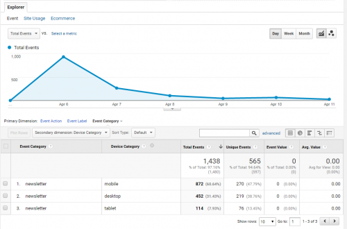

I added a Google Analytics event tracking 'pixel' to my email and I have found that about 50% of opened emails were on a mobile device. This percentage is skewed because we can't set the tracker up properly in NetCommunity (not without a lot of manual importing and exporting in Raiser's Edge and building an Excel macro to create the tracking code). But, I think it gives a good ballpark figure.
Reference: https://developers.google.com/analytics/devguides/collection/protocol/v1/email
My tracker looks like this:
<img src='https://www.google-analytics.com/collect?v=1&tid=[YOUR Google Analytics Code]&cid=1&t=event&cm=email&cs=bbnc&cn=Campaign Name&dt=Subject:&dp=Audience&ec=Event Category&el=Event Label&ea=Event Action' hspace="0" border="0">
The cid parameter should be unique, per user, being sent an email (ideally we would use the constituent ID). We can't do this NetCommunity because merge fields are images themselves, so I leave it as 1.
The cn, dt, dp parameters are viewable under Acquisition > Campaigns.
The last three parameters, ec, el and ea aretracked under Behavior > Events. I have found this to be the more helpful section:
Hope this helps.4
