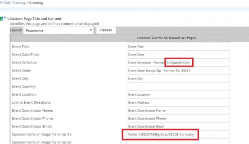

just tips -- You can still optimize the cannibalizing approach of such unused fields
) .. by adding your own delimiters
Those S47 field usually holds about 255 max character, and sometimes what I did is put delimiter that you could then translate that into JS array, thus one field could holds multiple data/references to something wanted to use to build thing dynamically into different placeholders
This approach we used it to display the honoree pictures and link to their personal pages and render Reception and Dinner time within each event greeting/landing page in similar fashion shown on actual i.e.
http://diabetes.org/foty
http://main.diabetes.org/site/TR/FatheroftheYear/FOTYContent?pg=entry&fr_id=11915

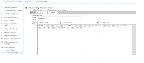

Or alternatively, build a Custom Page within that Teamraiser with text delimiter data (this would hold more characters beyond 255) and which you could also train/delegate your event managers to personalize that themselves through the (Event Management Center -- which is related to your other post/question)
This one we used it build route table data containing the miles for our cycling events i.e. : http://main.diabetes.org/site/TR/TourdeCure/TourAdmin?fr_id=11705&pg=entry
