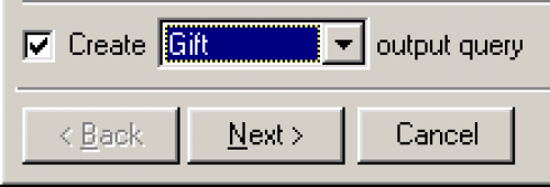

Also, you could use a Canned Pledge Report and check the "Create a Query" checkbox on the General Tab which should then create a Query of the Records from that Report...a process you can run a few times and then merge those Queries together or Globally Add an Attribute to be able to group them together. Still thinking you won't be able to actually get the Amount data you really want, though.1 -
I wonder if I could just create the output queries, then build out an Export and/or Crystal Report that is based off the output query. It's clunky, but it's starting to look like there isn't a streamlined option no matter how you approach this.
