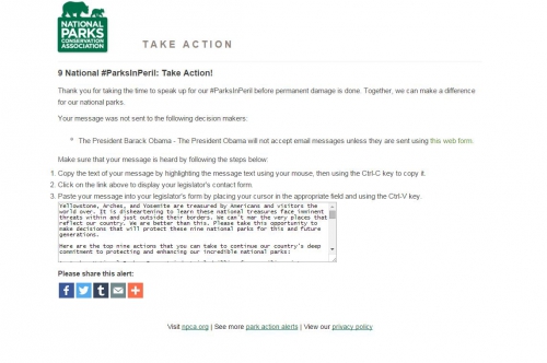

Sally here is what the user sees after taking action on this alert:
https://secure.npca.org/site/Advocacy?cmd=display&page=UserAction&id=1561
