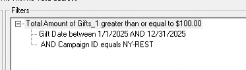

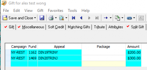

Hi, for the record as people who may see this.I don't believe what you said is true. Query is actually quite ok to export from and have used Query's summary of gift for long time and we do have split gift. So I went and did a test.
this is the gift:
exactly as you said would double count:
In this case, if you have a $500 gift with the Annual Campaign but split between Fund A + Fund B, then it will show up as $1,000.

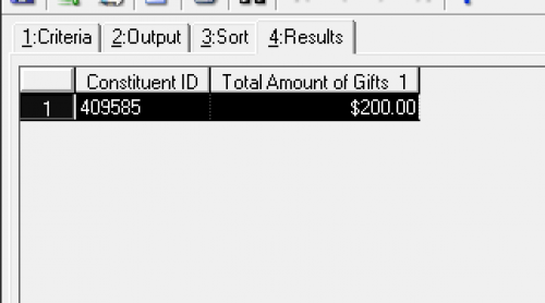

in my query criteria and result
you can see that the amount is $500, not $1000.

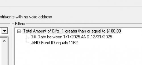

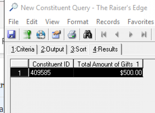

if i change the criteria to filter the summary by fund
the result is the sum of amount coded to the fund, which is $200 only.
