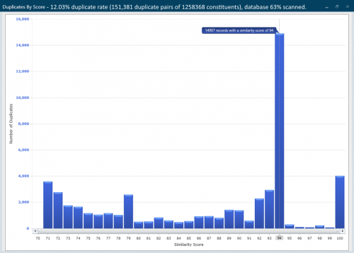

You can scan your entire database for duplicates (including non-constituents) for free with MergeOmatic, the duplicate constituent solution for the Raiser's Edge. You can download the plugin here (no registration required). It will find your duplicates, score them by similarity (a match confidence score), show you visualizations (see below) on the number of duplicates distributed by confidence score, and even visualize which users have created the duplicates over time. For merging (it comes with 50 free merges) it calculates which record should remain based on user-defined rules, and lets you quickly review and batch-merge them (or to do it individually if you like). Let us know what you find!
