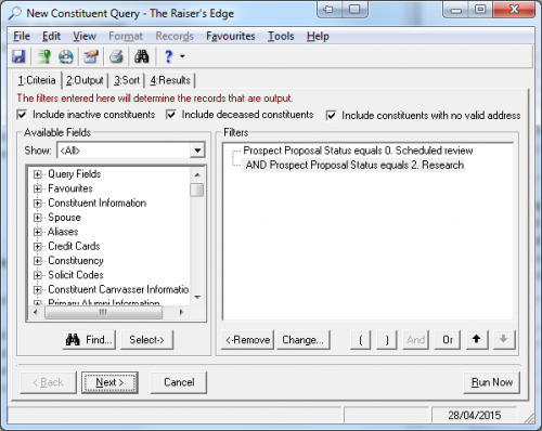

On occasion though, it would be really useful to identify constituents who have one proposal with one value and another proposal with another value. For example, I often think it'd be useful to find people who have multiple proposals in different statuses. Naively, we might try the following:
As we'd expect, this returns 0 records. Is there a way to make this sort of query work?
