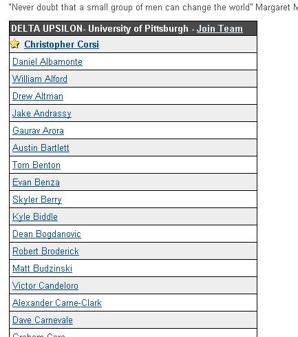

On the roster for one of my teams, the total raised is not listed next to each indiviual's name. It shows up on their individual profile, but not on the team roster. This problem is only ocurring on one of the teams on my teamraiser. Any thoughts on how to fix this?

Hi Nick,
Try to see if within your TeamRaiser > Edit
Within that:
Under "3. Select Event Options" "Related Actions" > "Edit Advanced Options" > "a. Define Fundraising Options" > "10. Top Participant Status Indicator Displays Amounts:" > "Yes, display the amount raised in the Top Participant Status Indicator" checkbox
EDIT: Also since you are saying within the team page -- might also want to check the setting # "18. Team Roster Displays Amount Raised by Participants" > "Yes, display the monetary amount raised by each participant in the Team Roster on the team pages" checkbox
if the checkbox is checked or not. Might want to check it to display the amount.
Either way those settings pertinent to displaying amount should be located within that Related Actions of that "3. Select Event Options"
Hope it helps, let us know.

Hi Daniel,
Thanks for the steps. I'm thinking there's some sort of bug going on. I went through the steps you suggested and all is well with those, but this one team roster will not show the amounts raised by the team members. All of our other teams are displaying properly.
Do you now of a feature that team captains can use to turn off the display? That's the only thing I can think of other than a bug.

For the record, the reason for this is that there's an SDP that controls the maximum amount of people on a team. If the total amount of people on your team exceeds that SDP, the total amount raised doesn't display on the team roster. You can work with support to have that increased based on your needs.
For the record, the reason for this is that there's an SDP that controls the maximum amount of people on a team. If the total amount of people on your team exceeds that SDP, the total amount raised doesn't display on the team roster. You can work with support to have that increased based on your needs.We recently had the same problem where a team had “too many participants” and the participant totals stopped displaying to the right of their name. Here is some code that can be used to solve this (can be put in the specific team's code area or in the Default Team Page code area):
