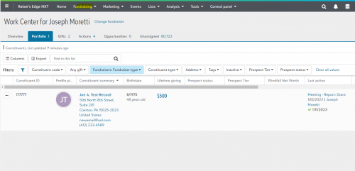

  • @Audrey Katzman This is pretty much what the Work Center does in RE NXT. Fundraisers only see the constituents that they are assigned to and no one else. Located in Fundraising, Work. Although I am not sure why you would want to restrict fundraiser's from not seeing certain records just because they are not in the person's portfolio, especially since fundraiser's portfolios can change all the time. Denying access seems somewhat short-sighted to me and I could see issues arising with this.
