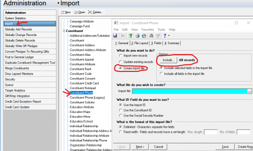

    You can do All records or use a constituent query to do a subset first

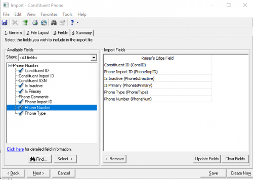

    At a minimal, you output these fields to create import file. You MAY not need to care about any phone/email that is already “inactive” as they normally won't show up anyway, so you can filter and delete all the inactive=yes first

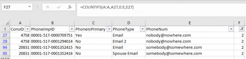

    Assuming this is the resulting file and you are ready to “blank” out the email (PhoneNum), see next screenshot
    38fad4edc8657854db18dc7fb3df5e1b-huge-im
    enter ^ replacing the dup email in the PhoneNum column for the dup you want to blank out (removing row 27 and row 94 as you are not making change to the email you keeping).
