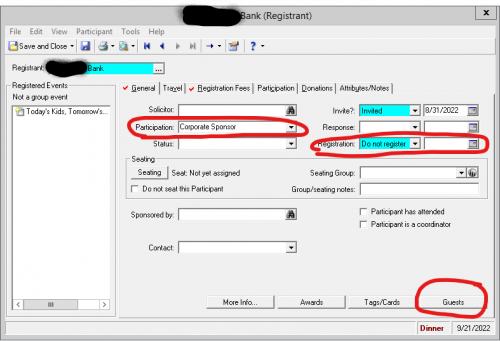

@Elizabeth Sarkaday - our gala is structured this way as most of our participants/attendees are guests of a corporate sponsor. We register the company, put Corporate Sponsor in the Participation field and then mark them “Do Not Register” in the Registration field. This way, they don't pull into an attendee list or into the seating wizard as the corporation is not attending, the guests are attending. Then, when we get the names of the attendees for the table, we add them as Guests and mark them as Registered in the Registration field. This way, the count is correct. This works for us in either RE7 Event module or in RENXT Event tab.
