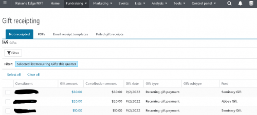

    April, even if you use OLX for your donation forms and regular emails, you can - and will probably need to - use NXT for your receipt emails for recurring gifts. I could not find a suitable way to do this in database view, Mailchimp, or Online Express. We literally do not use NXT emails for anything else except this function.
    • In NXT, create a Gifts List with criteria: recurring gifts processed this week.
    • Then, under Fundraising - Gift Receipting, upload the query.
    • You will need to probably adjust your email template there (we added branded headers, etc.)
    • You checkmark the ones that need receipting, and then send.
    It should look similar to this:

  • @Sheila Wortham
